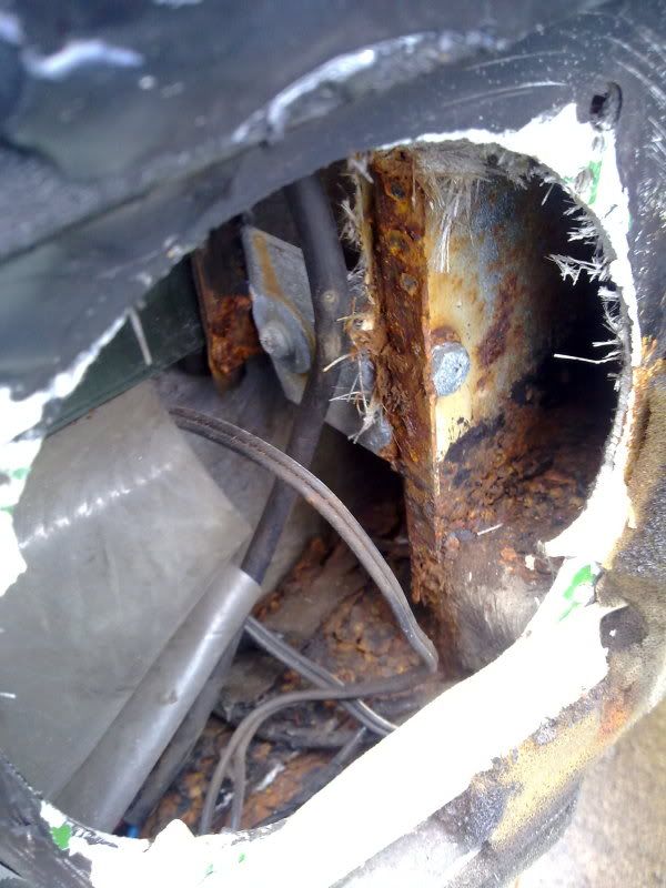

Took the door cards off today to check out the door inners, and guess what ????
More rust....
The support structure for the lower hinges on both sides was nothing more than corn flakes. This explains the terrible door sagging. On a positive note the door frames look fine..
Spoke to Nigel at QRG to ask if he had any repair sections and he told me not to bother. In his experience he says that thickening the area with plenty of GRP is the best solution, and to get rid of as much of the steel work as possible. This sounds like a damn fine idea to me as it means I won't have to cut the door up to replace the steel work. Time is running out though, so I may get SP Automotive to do it whilst they're fixing all the stress cracks and doing the paint.

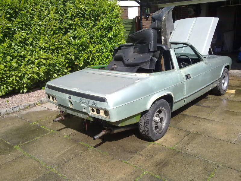

A bit more progress this week.

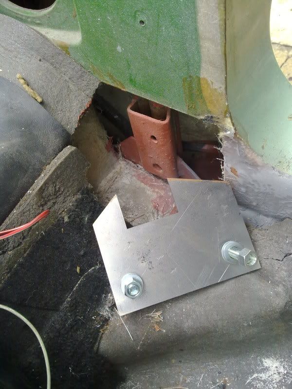

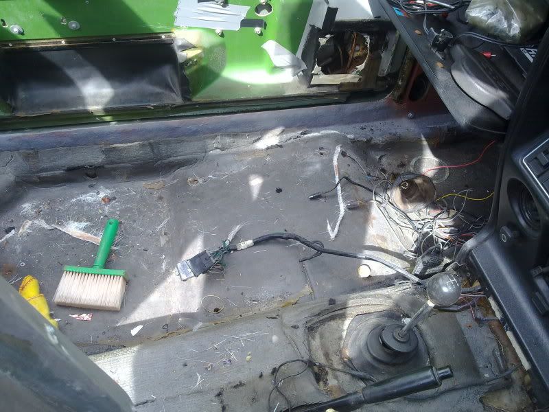

The inner sills are now finished. Rust proofed and glassed back into place.
My QRG order arrived and this is what the roll bar repair section looks like

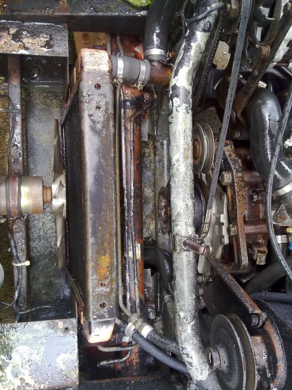

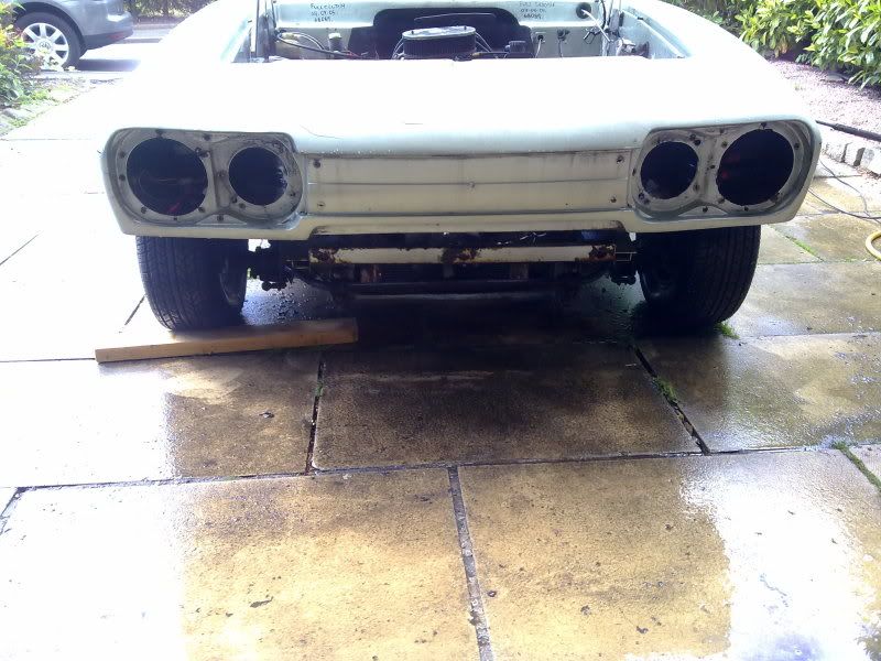

Bumpers and lights finally removed. The bumpers took some persuading, but having done this job last year on HOM I knew where all the fastners were, and knew that the easiest way was to snap the rusty bolts with two big breaker bars with deep sockets.

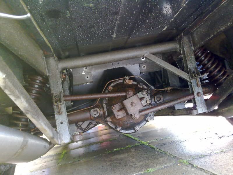

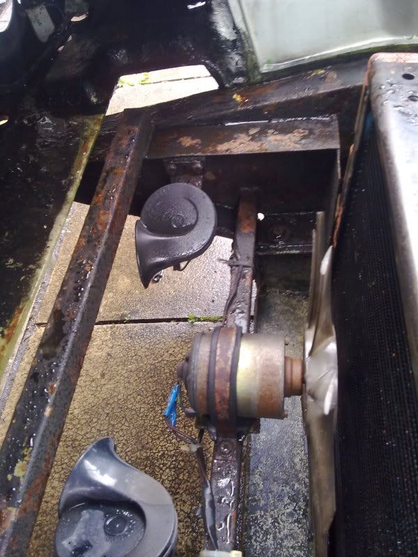

Engine bay and under the car has been pressure washed. The galvanised areas have stood up to years of neglect really well, especially the front plate under the radiator. The nose cone supports are very good too (surprisingly)
This what the inner door supports look like......

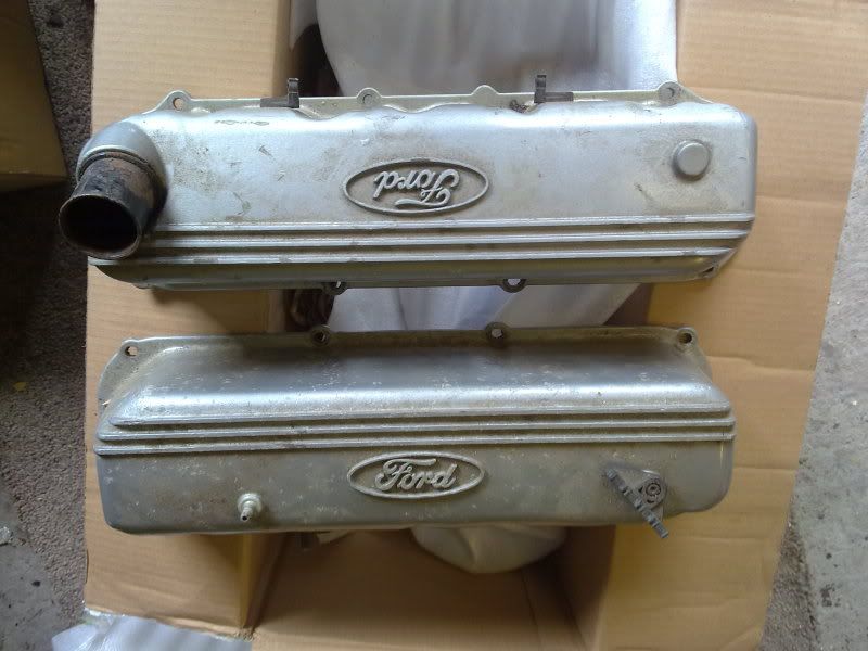

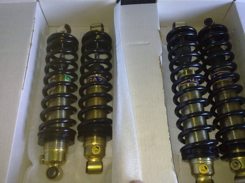

And finally to boost my spirits, I got two very welcome deliveries today :-
