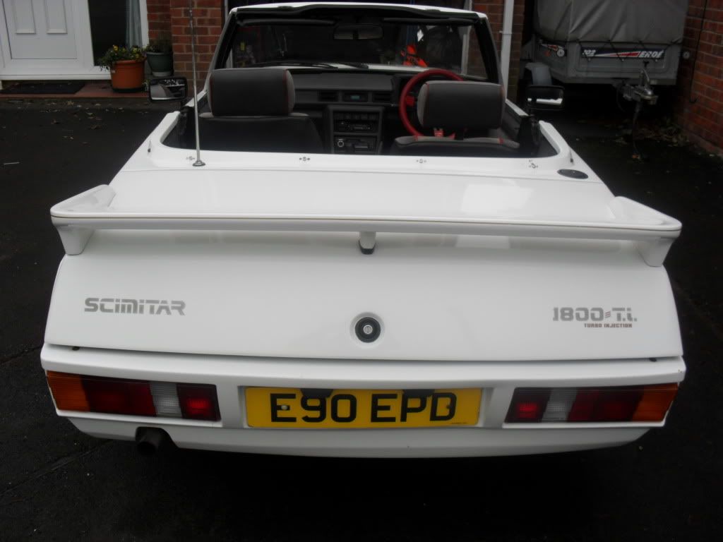

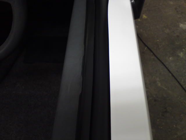

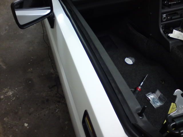

A bit of an update. As previously stated I have removed both quarter lights as they were rotten; in fact I vacuumed them out of the bottom of the doors :( I intend to drive the car whilst I source some replacements and have been trying to think of a way of tidying the door tops now the frames and glass are out. I cam up with the idea of a rubber stip fittied in the gap between the door car rubber seal and the outer door skin (I have removed the rubber seals) I purchased some 50mm wide x 2.5mm thick rubber strips on Ebay and have now fitted them in the gap. The strips hold themselves in place and finish the door quite nicely. Below are some pictures.

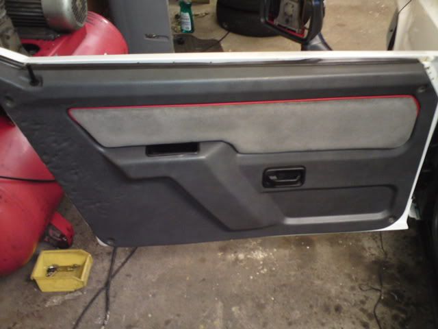

I have also fitted some replacement door cards which look much better than the old ones although not perfect
Car is booked in for its MOT next Thursday so Next job is to wire brush and rust proof the front and rear suspension (shame that Reliant did not galvanise along with the chassis!)

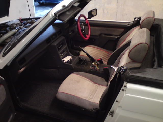

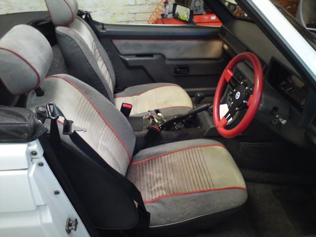

A bit more progress; old seat removed and carpets cleaned. Old seat from my 1600 refitted and the cleaned up original. Mountney steering wheel in red fitted. Looks pretty tidy now IMHO.

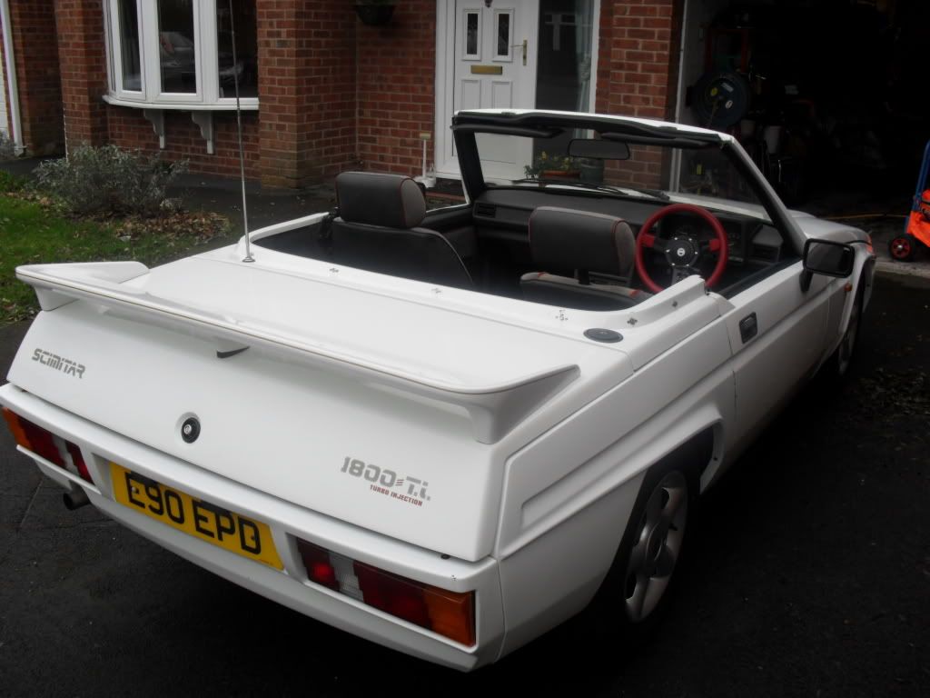

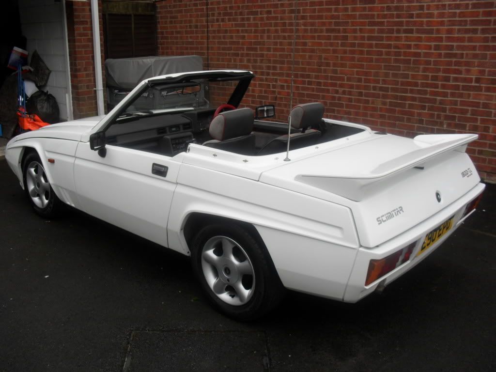

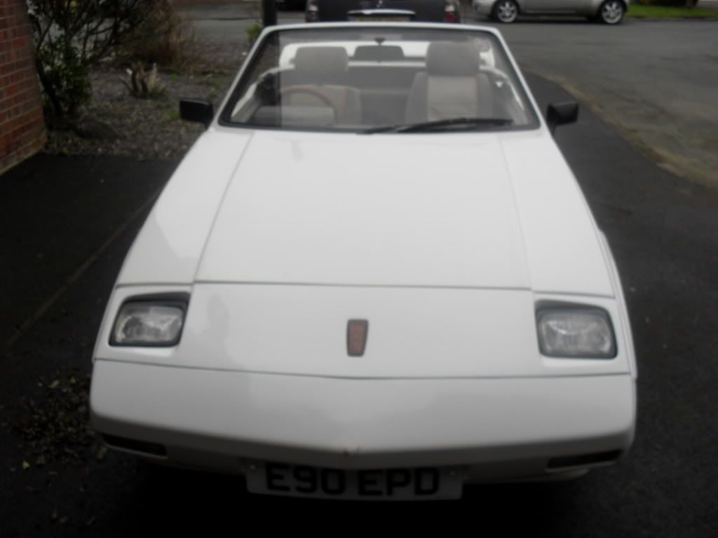

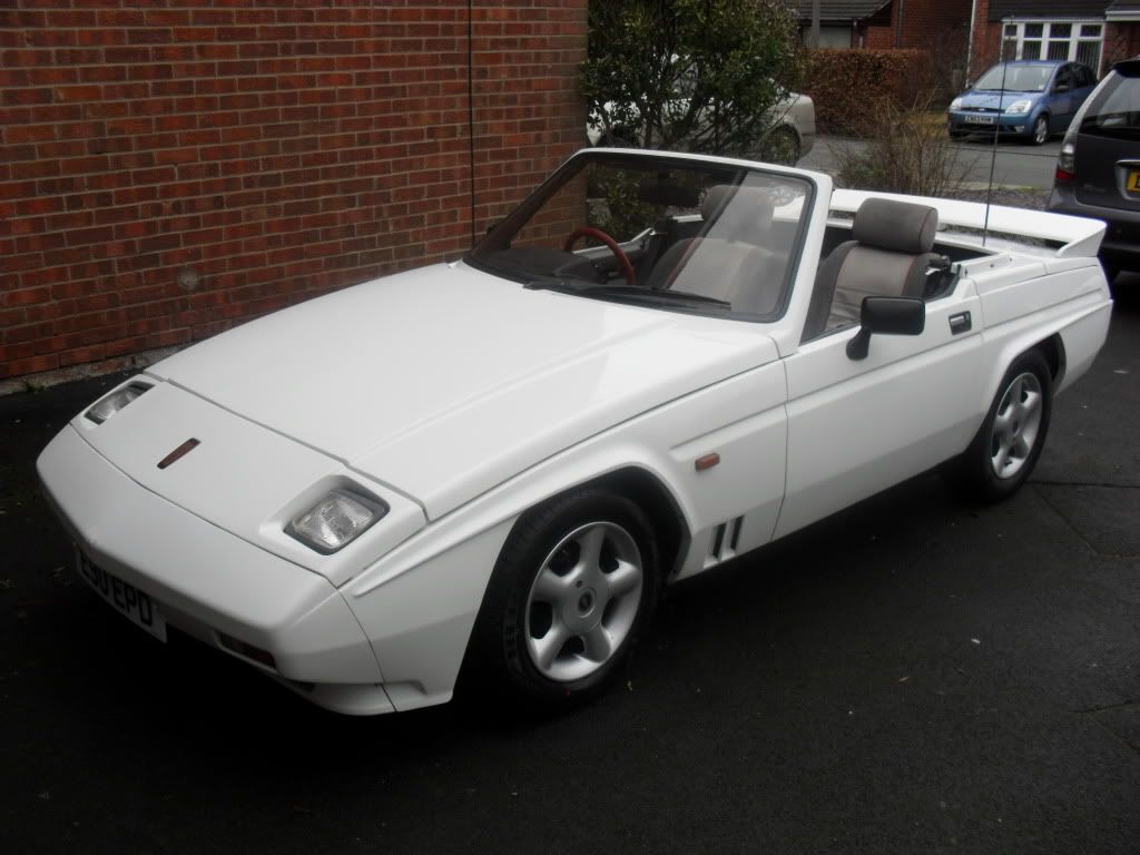

Took the car out today for a short blast round my estate before its MOT on Thursday. Boy do Ti's shift :D When you give it the beans the turbo winds up and your pushed back in the seat. Even my 13 year old Son was impressed; and that's praise indeed because he's at the grunting stage at the moment and little impresses him :lol: This is my first drive of a Ti; well happy and should be a great car for the summer. Good news on the brake front; all seems OK and they pull up sharp (ish) and true in a straight line so hopefully OK for the MOT unless they are picky about the condition of the discs. Spent a few hours with the T-cut and Mer this afternoon; it polishes up quite well. Some pictures below. Steve

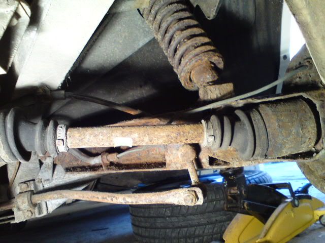

Post by swoakes » Thu Feb 24, 2011 5:51 pm
Below is a picture of the O/S drive shaft.
Posts: 4677
Has thanked: 75 times
Been thanked: 118 times
Re: 1987 SS1 Ti
Post by reliant-reviver » Thu Feb 24, 2011 7:31 pm
Standard tri-lobe driveshafts. So in all probability it doesn't have an LSD, unless it has been fitted with an aftermarket differential e.g Quaife.
