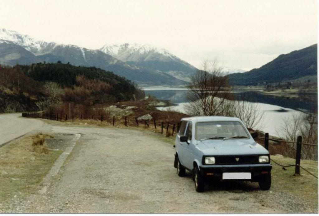

Post by Will Anderson » Thu Nov 06, 2014 8:35 pm
DARK STAR wrote:Go for it Will, wish I'd never sold mine.
Mind you, I wouldn't fancy driving it from York to Antibes ...
Don't!, You are as bad as Andy, look how many photos he has put up today!! :lol:
I think I have posted this before but this was the one I wish I still had.
