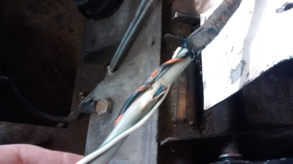

The fault on Dad's old sabre was down to one of the wires in the loom that runs along the chassis by the turbo. There was one that had its insulation damaged including a screen layer. It was sorted when the engine was out

Yes as josh says
Take a look at my thread here
http://www.scimitarweb.co.uk/sgwrs/view ... 45#p324786

Suggests its interference, turbo heat often wrecks the heater motor supressors and if less than ideal cable was used by factory 8e little or no shielding, it could well be that
