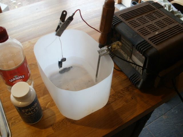

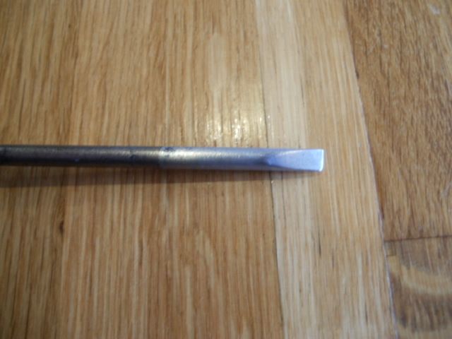

I had a quick go with a very basic set-up last night & got some good results;
This was just using 100g of epsom salts dissolved into 500ml of distilled vinegar, with an old AA battery case as the source of zinc.
The charger was on its lowest 6v setting & it took a couple of hours to get a decent plate on the old screwdriver tip but this is likely because the zinc needs a bit of time to get into the solution, and should speed up with more use. An alternative would be to add zinc sulphate to the solution but I was just keeping it simple & cheap this time. The total outlay was just £2.16 for the epsom salts & vinegar.
