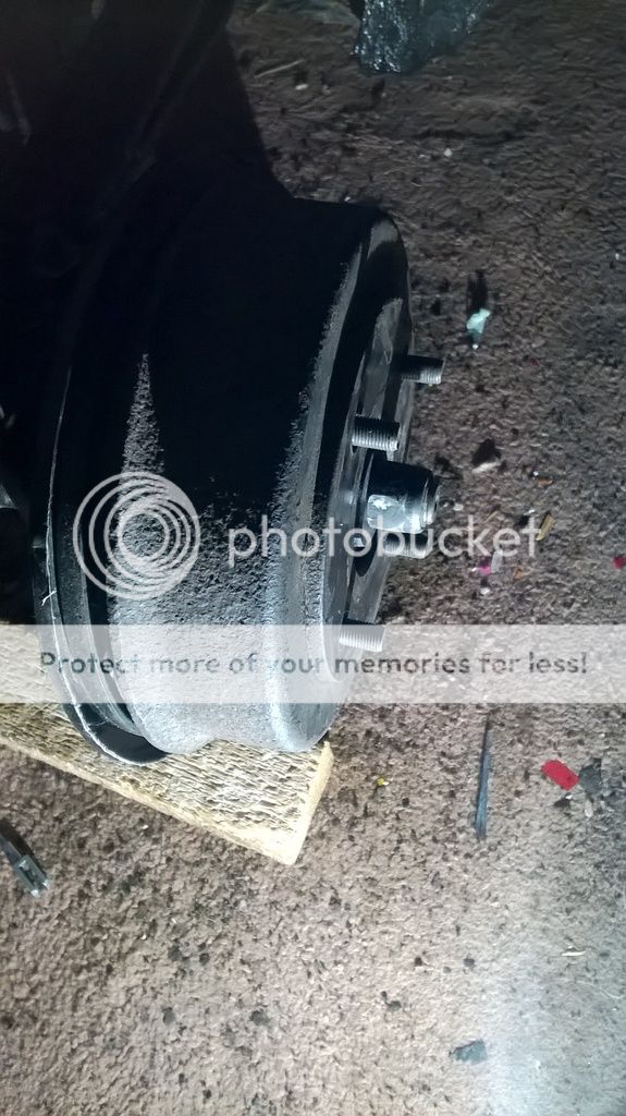

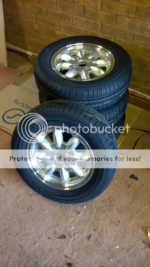

Whilst the cipher had been away, a new set of 13" wheels had arrived - to allow for the disk brake upgrade that will go on the cipher (see Dave's Green Cipher Thread for the idea).
Now the 13" wheels work fine on the front - just a simply add new wheel studs and a 10mm spacer. But the back axle is a different story - it requires 15mm spacing to clear the rear springs. For the cipher that could mean using 2 spacers together (5+10mm) or get a custom spacer made. But with the thickness of the alloy wheel that would need wheel studs longer than the 55mm ones used at the front (standard are 35mm) - probably 65mm. This got me thinking there must be a better way to do the whole thing (dangerous thought :roll:)
So one thing that could be done is to use a Reliant Fox drum and 10mm Spacers, Fox drums are not only sturdier than the kitten drum, but also have a 5mm spacer built in (see photo below) - so change the studs to 55mm add a 10mm mini wheel spacer and Bing ! your done.

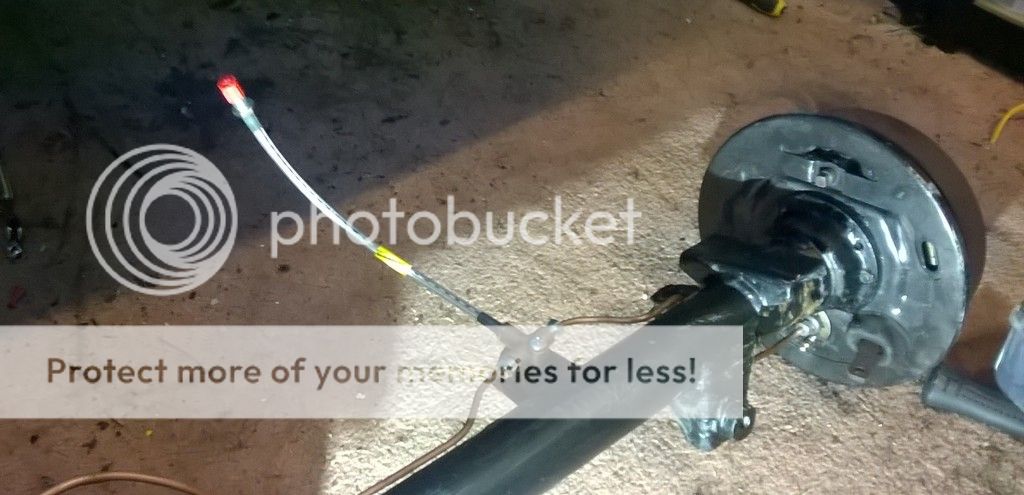

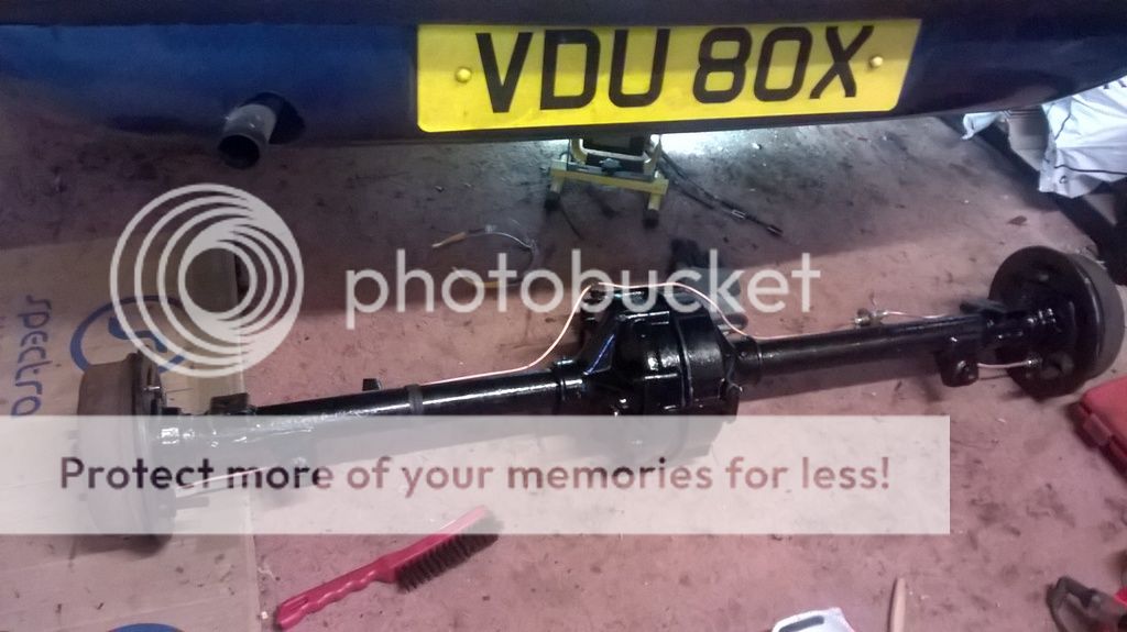

But then after thinking about the Fox drum - I realised that if I swapped the kitten van axle (which Ciphers use) for a Fox Axle - as the axle is 3/8ths of a Inch wider in the right directions than the kitten one, I could do away with the spacers all together - a proper engineered solution - and probably one reliant itself would have followed if it had built the cipher. Now Fox axles are rare and not only that, they have a gear ratio of 1:4 (rather than the 1:3.5 Kitten Van) - fortunately I had a Fox axle to hand and with a little help from Keith suitable new internals were fitted to give a gear ratio of 1:3.23 (standard Kitten). Upping the ratio whilst reducing the Ciphers acceleration a little will fortunately make it cruise at motorway speed a lot better, give a higher top speed and all at revs that wont make my ears bleed any more !
So the old axle was dropped and the nicely cleaned upgraded Fox axle presented to it.

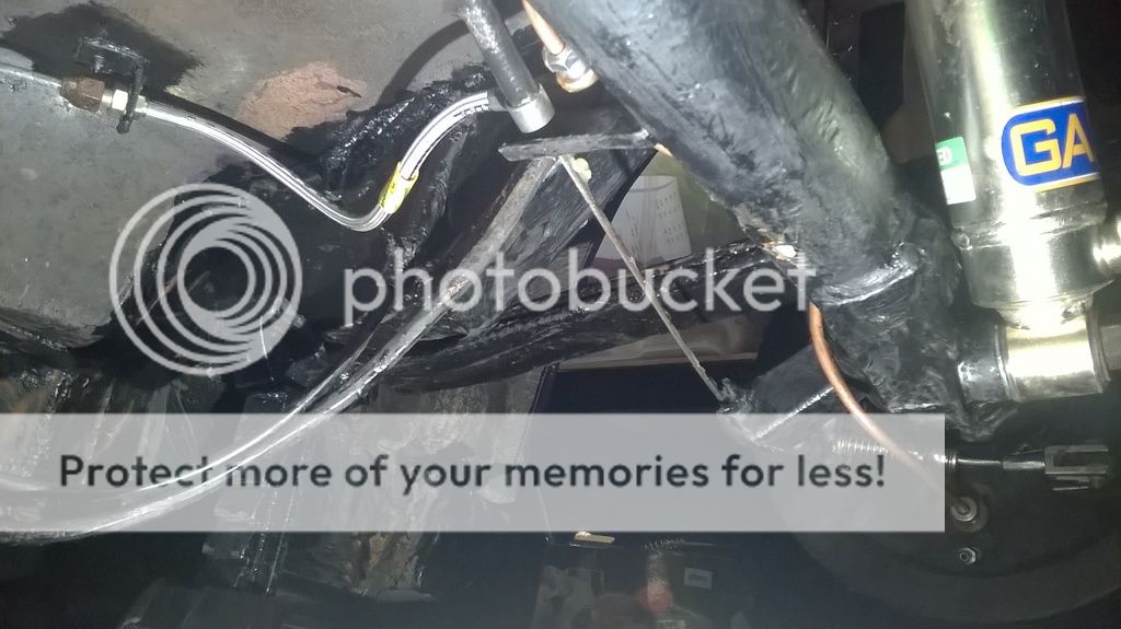

But just before I fitted it I realised it was the ideal opportunity to repaint/reproof the back chassis - there wasn't any rust, but the paint was looking tired and access was now fantastic - too good to miss ! This delayed things by a couple of weeks as painting the chassis and work got in the way of progress - but by the end of it we had a beautifully painted back of the chassis to match the axle ! The front of the chassis will be done when we get the engine out later.....
So on with the braided Kitten brake hose....

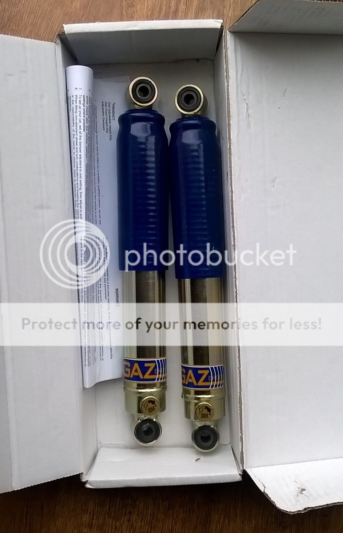

add a new pair of adjustable rear shocks
add new wheel studs, put it all together and attach it back to the cipher....

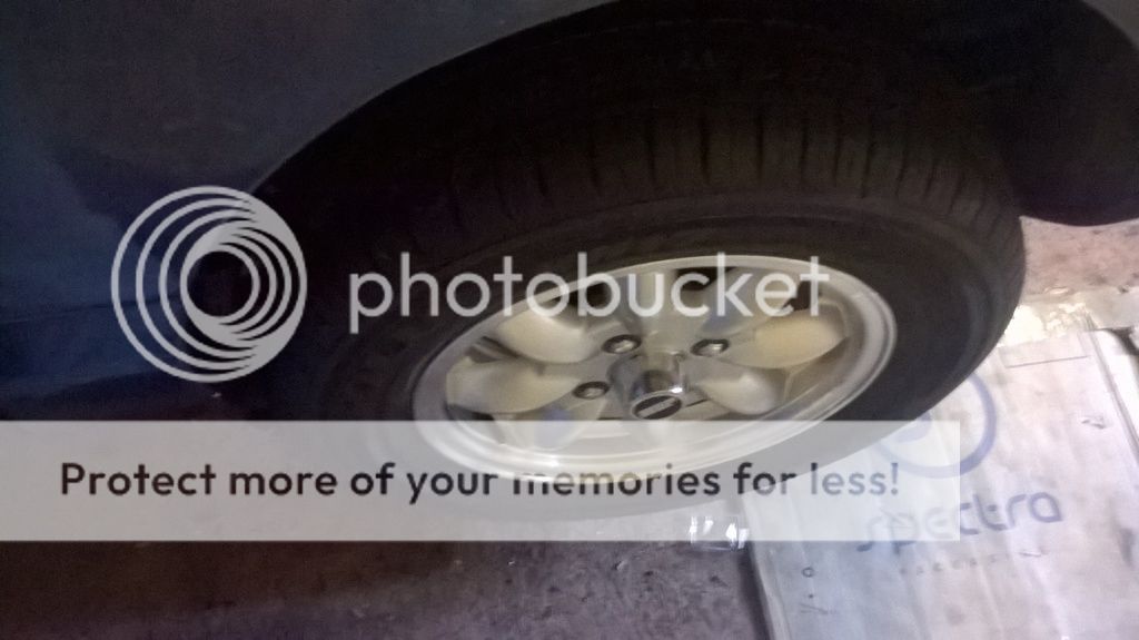

and finally add the back wheels - I should add that this thread does make it look very quick - actually this process took over 2 weeks of grabbing a few minutes here and there :lol:
I then checked the back wheels clearance from the springs - which were a healthly 8mm per side - which is what Dave (see Green Cipher thread) has achieved with spacers - so all good and on the money. Additionally the wheels are well within the arches - which is a good thing - I won't bore you all with the carefully prepared vertical photo which just shows the body work and my feet that I took to check it though !!
So all done and back on the ground with an upgraded and refurbed rear axle - and no spacers on the back - even with 13" wheels - a big success although it took some time !
