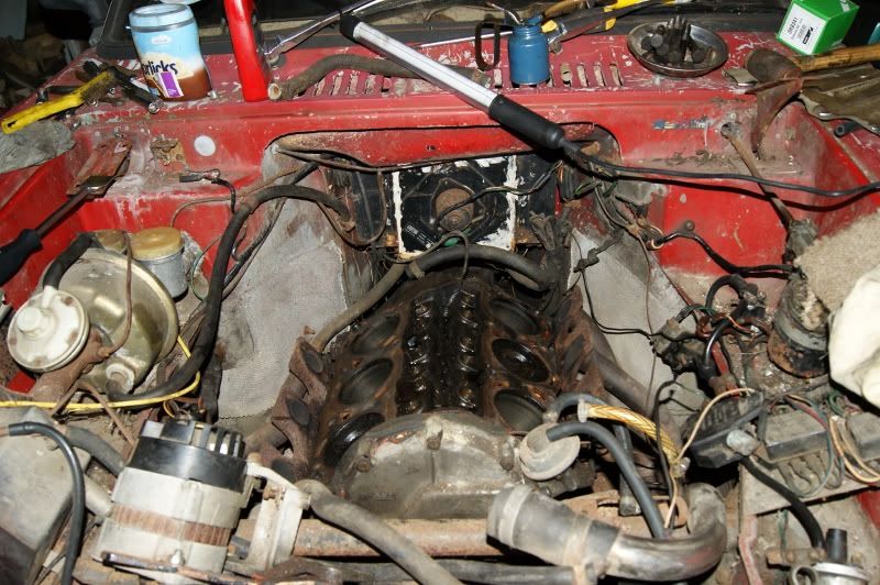

The engine wouldn't start. It didn't help that the keys are lost, but once this issue was bypassed the starter blew up after a few attempts. A secondhand starter solved that, but despite working through the electrics and cleaning the carb, I could get it to fire but not start.
Eventually I compression tested it and found poor compression on cylinders 4 and 6, reasonable (130psi from memory) compression on 1,2,3 and it was not possible to get the tester into 5 because of the bulkhead proximity. One of my other cars is an Esprit, in which access to everything is a nightmare, so it is refreshing to find on the scimitar that 4/6 of things seem to be accessible and only 2/6 of them aren't.

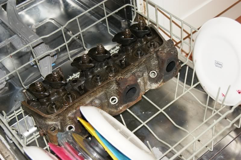

I took off first the rocker covers and then the heads, hoping for something simple like stuck valves. It was evident that the head gasket was leaking on 4 and 6, which is a simple thing, but it didn't look bad enough to prevent the engine starting - I've seen much worse on cars that were still making good compression and running well but just with overpressure in the cooling system.
So I am still a little puzzled about why it wouldn't start, but will put the heads back on and give it another try. I wasn't very impressed with the magnitude or consistency of the spark so I will also get a new coil. Plugs and leads I already renewed - some of the leads had rodent damage.
I gave the valves a light lapping before reading in the manual that the inlet valves are aluminised and shouldn't be lapped. I have not come across this before and the internet wasn't any help either, does anyone know anything about this?

I have got the engine back together and it runs. Water pump and bottom hose were completely clogged up, and the pump also leaked, but there were two spare pumps in the boot so I put one on and it seems ok.
Clutch seems operational as well, which surprised me.

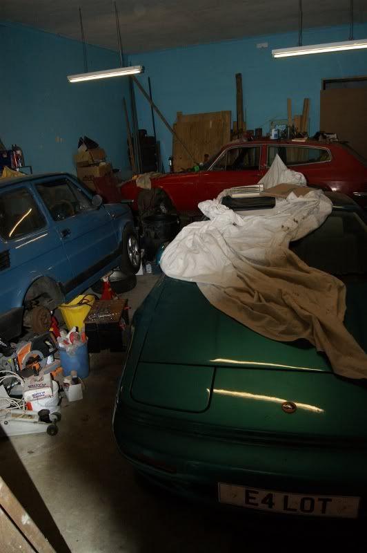

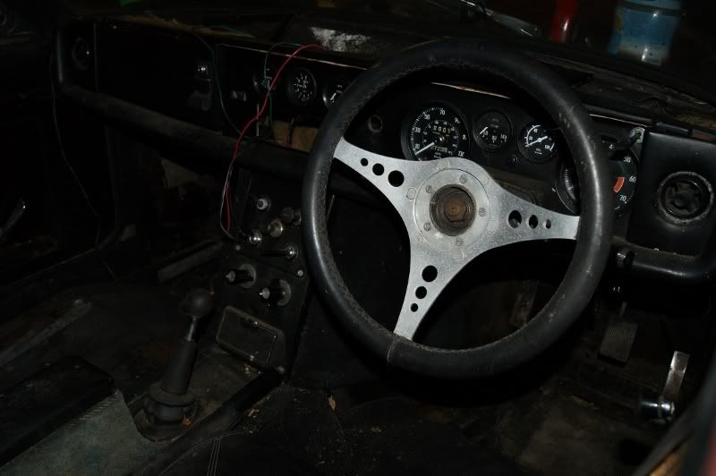

As received
Esprit has been put back on the road in 2013, just SORNed it for the winter.
The 126 was an EFI project related to my previous business, spent a long time thinking about motorcycle and Toyota Aygo engines, eventually converted back to carb and gave to the guy I got the Scim from as something for his son to use.

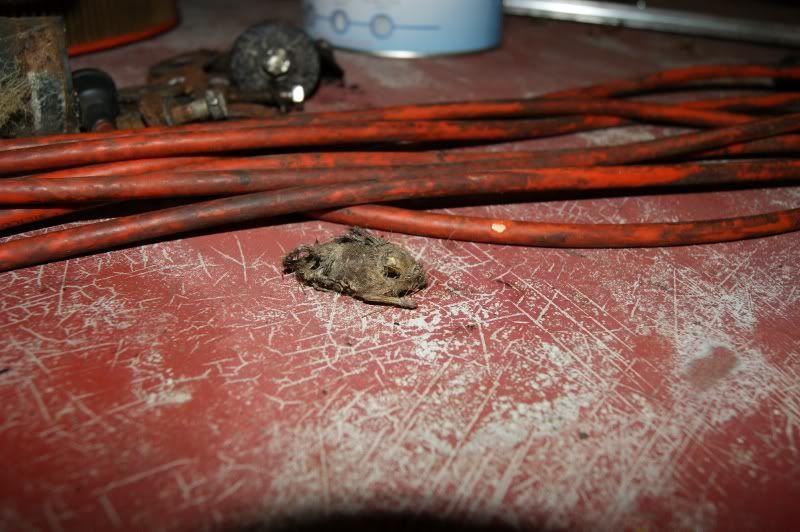

Here is one of the previous residents, looks like he used to eat HT leads. Also note the general condition of the paintwork on roof and other upward facing surfaces.

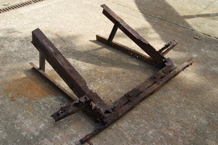

Found this pile of rust trapped under the back. Previous owner must have run over an old fiat or something.

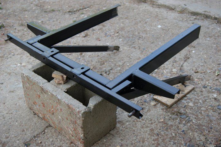

Made a new one, welded it in from above & below
Fairly common repair I believe

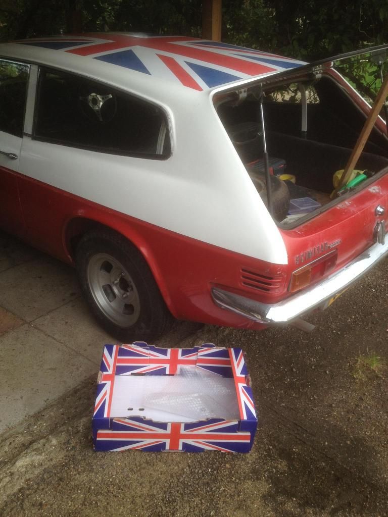

A bit of a spruce up by painting the top half with boat paint and a sticker to celebrate the jubilee 2012

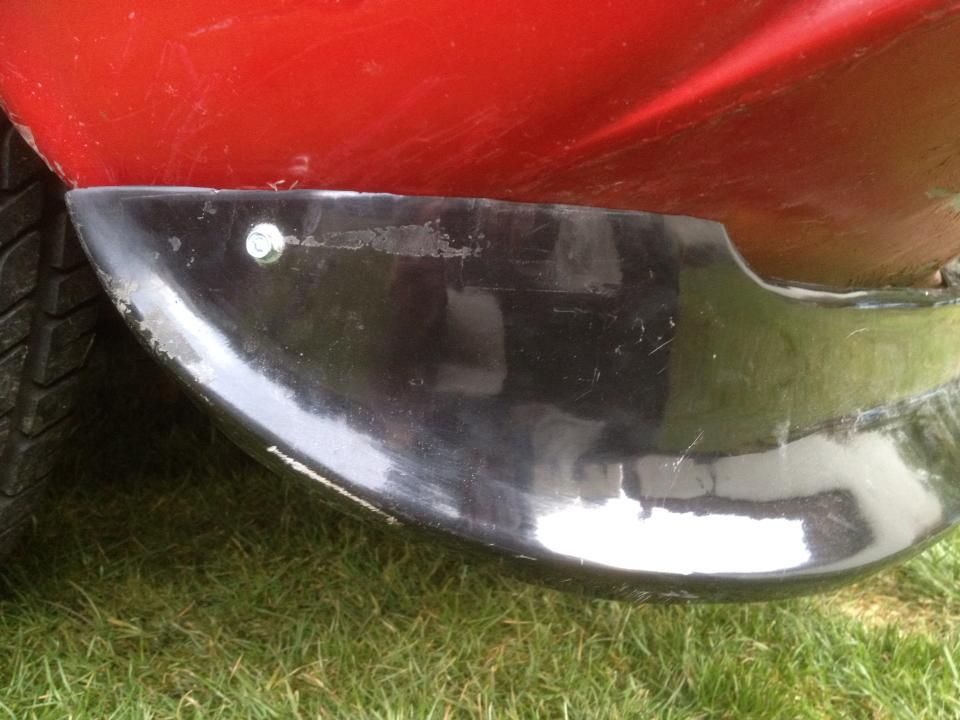

Trial fit of spoiler.
Considering it's not meant for a scimitar, it fits well. I might trim it a but more, depending on final ride height choice.

Did you make up that rear part of the chassis yourself? If so, that's impressive! Looks good!

Thanks, yes I made it. The main rails were made from box section that I slit with a jigsaw to make an L section, also with a small lip at the bottom to provide a similar overall profile to the original Z shape. I'm pretty happy with how all that went. The outriggers had previously been replaced, but had some issues, I did what I could with them.
