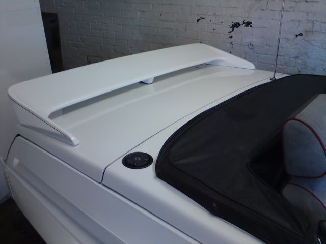

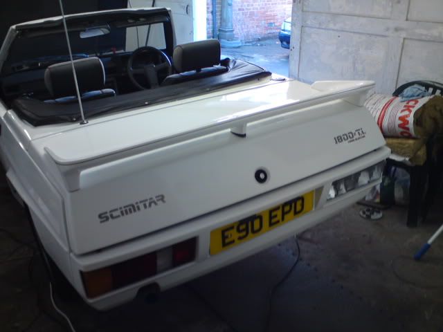

Post by swoakes » Tue Feb 01, 2011 7:15 pm
A further update on progress along with a few questions:-
I have received and fitted a boot spoiler (MR2 Mk1) in white which is an amazing colour match for the car.
The hood cover has been fitted after some work with a hair dryer to stretch it; some poppers need refitting and 1 new required.
The indicators now cancel on the steering wheel as they should.
Started to clean up suspension and check brakes for MOT
Only lights not working are front fogs.
Some questions:-
What mountney steering wheel boss fits the SS1?
Is it a requirement of the MOT to have front fogs on an 87 car; the front fogs are rusted away so may just remove for now. Will I need to blank the switch also?
What is the best way of replacing the large rubber pipe between tank and filler neck? Can I disconnect at the tank and pull through the hole in the rear deck? Not sure I can get at the jubilee clip where it joins to the filler neck above the rear inner wheel arch.
Thanks

Thanks Roger the spoiler looks good (IMO) but the added weight means that my boot no longer stays up on the stays :( Has anyone fitted uprated ones to solve this?
