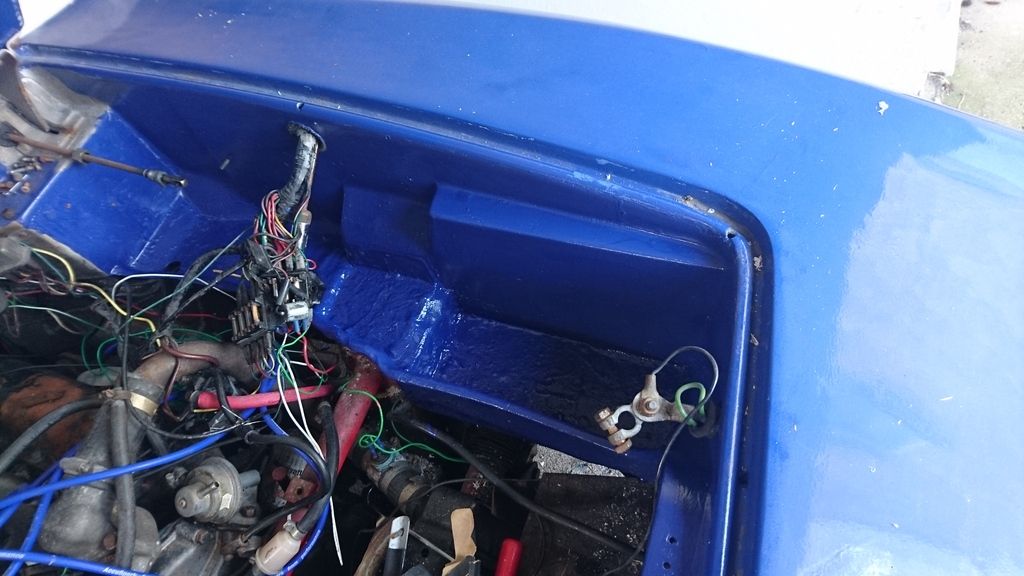

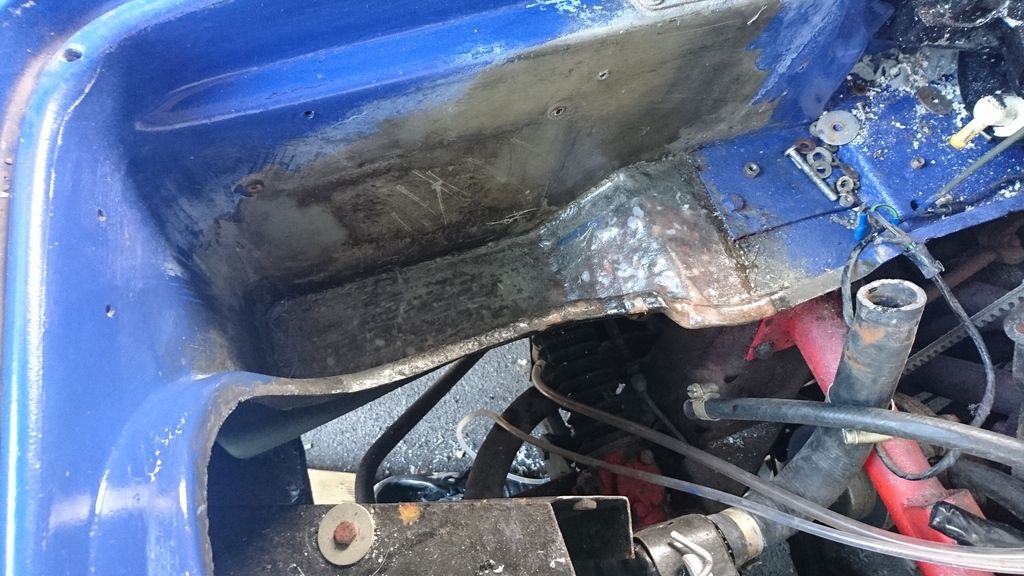

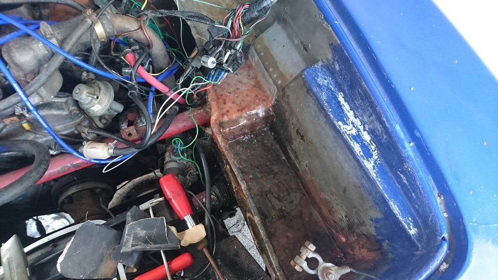

I can tell you are all on the edge of your seats awaiting the fibreglass update. I fear some of you are experiencing a massive repair. What happened twas, I'm planning to replace the cable running from the battery to the starter. I was aware of a crack in the fibre glass near the battery bay. I'm planning to attach the battery lead to the bulkhead, so thought I best repair the crack before I did. Photo of crack

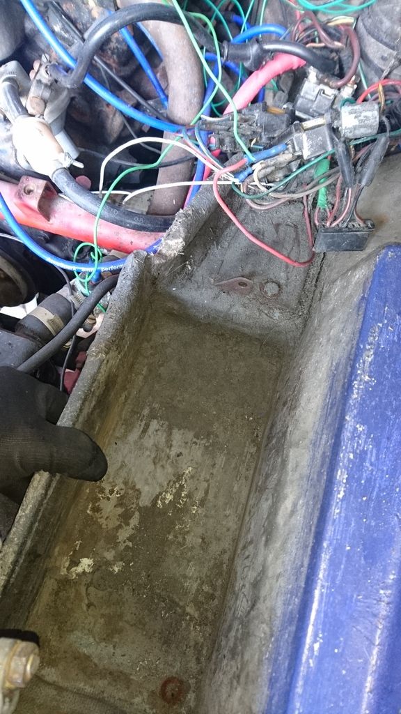

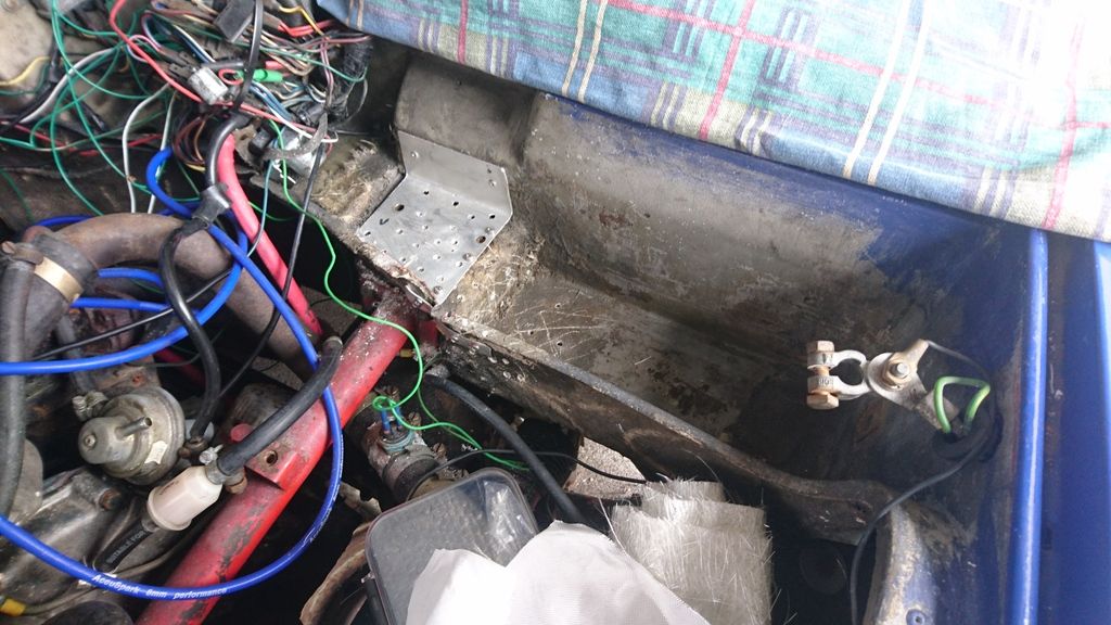

After picking off a previous owners attempt at a repair, it became apparent that the problem needed a larger repair and I elected to reinforce some bits with some metal work.

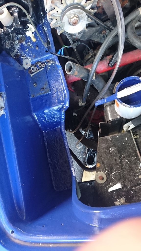

Whilst I was doing this I noticed 2 more cracks in the battery bay, one where the remote solenoid fits, the bonnet lock area was a mess of failing bodge repairs and 2 further cracks in the area of the washer bottle :w :w :w :w After addressing all these the engine bay looked like this.
I managed to get some painting done this morning waiting for the shopping to arrive.
Well there you go just needs another coat and then refit all the bits which I've taken off for access and I can fit the starter as originally planned :roll:
