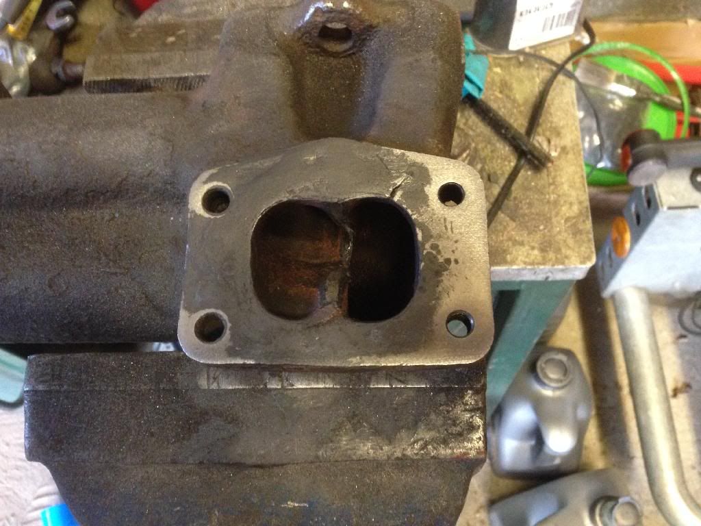

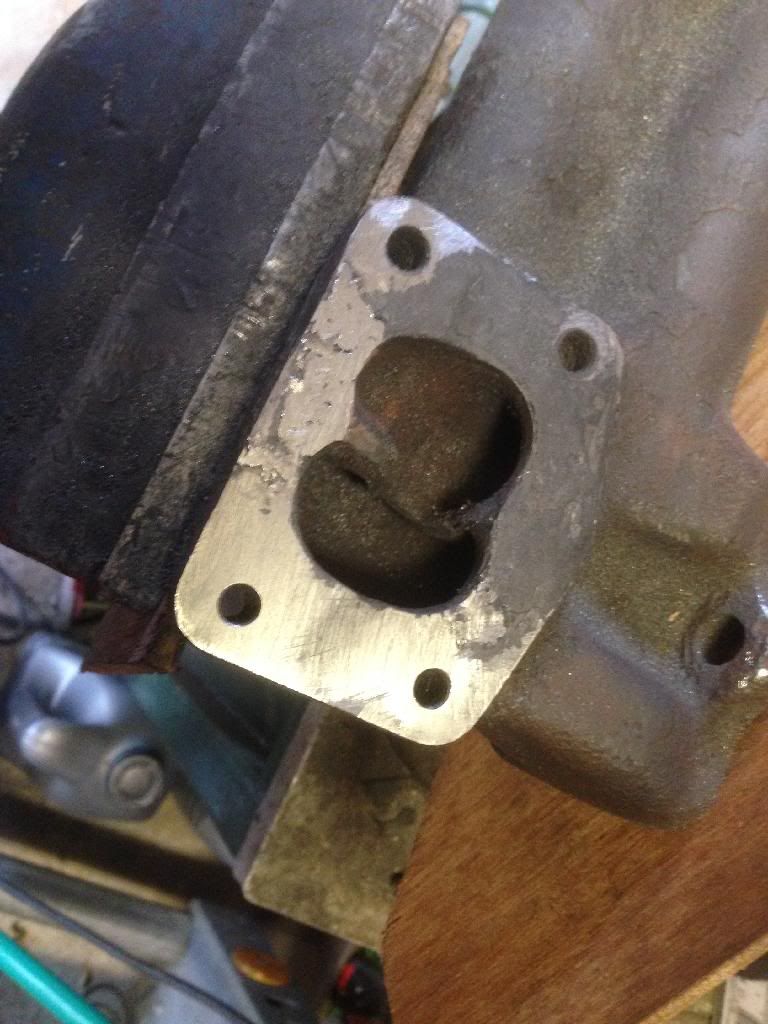

I managed to fill the holes in one with a MIG. I'm certainly NOT an expert welder :lol:
This is after filling the first couple of cracks.
This is how it looked before I had it flatted off.

Post by manny » Thu May 26, 2016 5:30 pm
Good day all,
well got the welded manifold back - relieved of £20....
inside needs a bit of smoothing\cleaning up but has done the job i think.
Banjo bolts and washers arrived this morning - but still need to order new studs...chap tells me the manifold was heated to cherry red and the weld pooled in the areas needed...I am guessing it still has the same shape...i will trail fit it at the weekend to get an idea of how difficult it will be

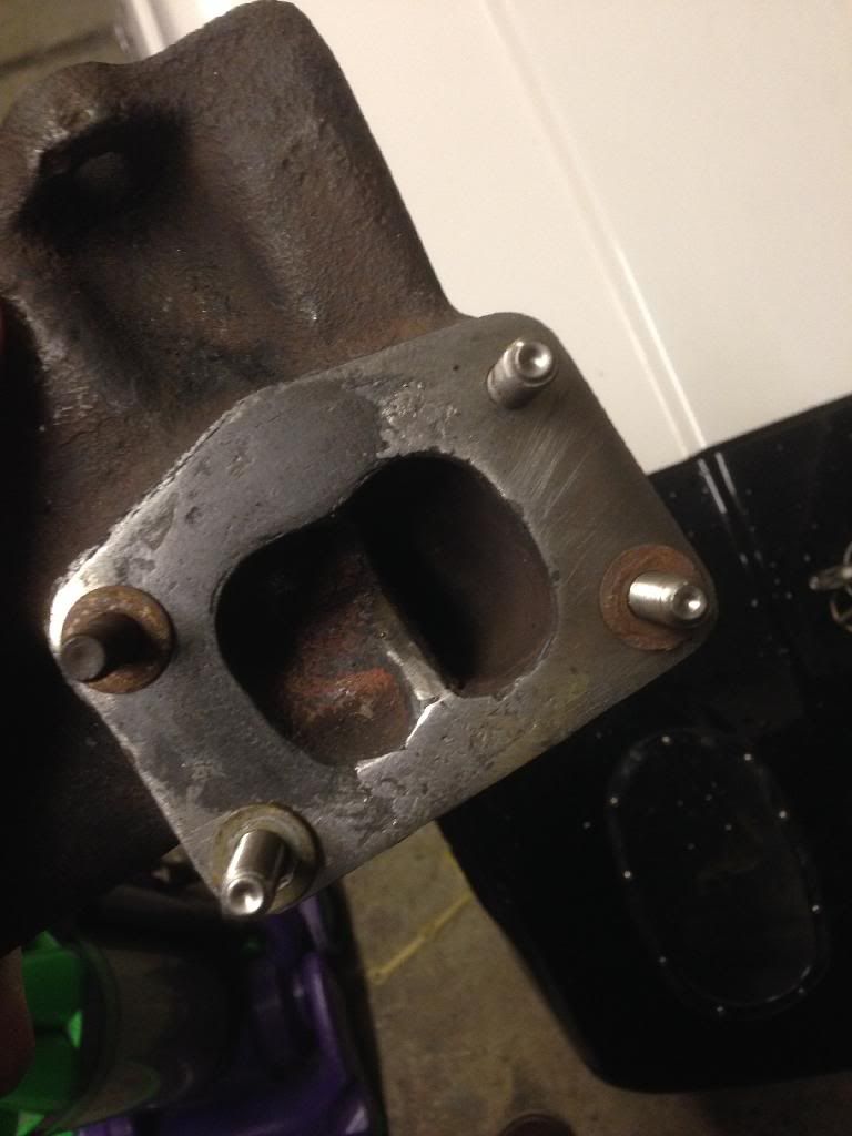

well I managed to smoothout\remove some of the repair splatter....so thought i would just test fit the turbo to the exhaust - battled for about 30 min - but could not get it house...then I took some pics:
Image Image
okay....WT..flaming trousers :shock:
the housing does not look like its missing a tag...but the middle stud hits the edge of the housing ...so what is going on here.. why are there only four holes??
Ta
Manny
Posts: 11634
Has thanked: 380 times
Been thanked: 268 times
Re: Manny's SS1 1800 Ti
Post by Corky » Sat May 28, 2016 7:09 pm
One of the bolt holes on the turbo isn't always used. IIRC I've done one of each type.
manny
Posts: 1261
Joined: Sat Sep 29, 2012 10:11 pm
Location: Smethwick, West Midlands
Been thanked: 26 times
Post by manny » Sat May 28, 2016 7:16 pm
Corky wrote:One of the bolt holes on the turbo isn't always used. IIRC I've done one of each type.
okay...just chop of one of the studs would be the best option.. :) thank you sir..i almost started crying...
Posts: 11634
Post by Corky » Sat May 28, 2016 7:23 pm
Don't chop it :lol: . Remove it gently and put it in your spares box.
