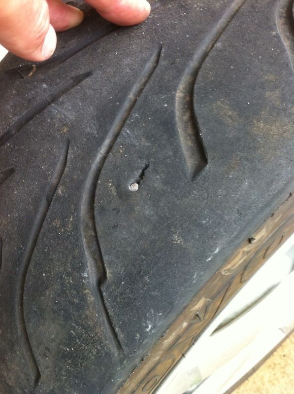

:cry: Just before 2nd practice Nick Keyser noticed I had a puncture on the rear right :shock: Panic sets in and Nick very kindly lends me a couple of wheels with the same tyre type on them :D :D :D
:? Lots of messing about ensues, and I end up putting my fronts on the rear and Nicks tyres on the front (It was the only way with the mixture of offsets and spacers I had)
:( Finally get the wheels on having missed my practice slot and I line up with the expensive Fiats, only to hear a big clang so I return to the paddock
:D Torque setting on the wheels checked again, and clang put down to the suspension settling down again after having the car jacked up :shock:
:D Finally got out again at the back of the batch of Ferraris and put in a half decent lap IRO 71 secs.
:D Did my 3 timed runs, and all seemed to go well. Though the car had started to oversteer as Nicks tyres (on the front) were in far better condition than mine (on the back)

2/ The puncture has forced my hand a bit, so on the advice of many compies I'm going to try some Kumho soft tyres. I'm going 195 up front and 205 at the back to start with. These may get bigger as time goes on, but the current budget dictates this. I could replace with the cheaper R888's, but I've found a couple of reasonable deals on the Kumho.

DONT use new sprint spec Kumho tyres on a track day, will destroy them!!! your old R888s should be ok though. id have that puncture repaired. As its not for raod use, (elf n safety etc etc) the garage should repair it

CNHSS1 wrote:DONT use new sprint spec Kumho tyres on a track day, will destroy them!!! your old R888s should be ok though. id have that puncture repaired. As its not for raod use, (elf n safety etc etc) the garage should repair it
glad you enjoyed it :-)
I think I'll take it to EARS. They should know what they're doing with B tyres.
Fair point on the track day use, I'll use the R888's if I can get it fixed...
Watch the way the Kumho wear on the edges of the tyres though :shock:
