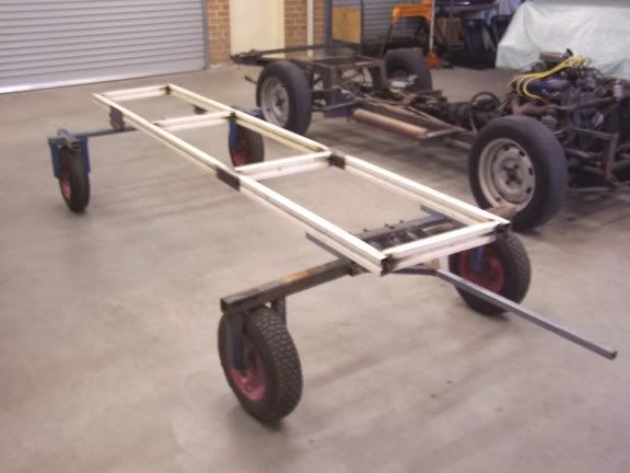

A new replacement chassis was needed; so it left me with no choice but to fabricate one. I studied the chassis and its construction carefully before dismantling the car, and took lots of measurements before deciding that a new chassis could be constructed using similar factory principals. Although the original chassis was very rusty, fortunately it was straight and original enough to use as a good pattern.
I carried on with lifting the body from the chassis, keeping the body complete as possible, the only components needed to remove from the body to accomplish this task were the bonnet, fuel tank and front and rear bumpers, all else remained intact. The body was lifted carefully using a custom made lifting fixture, block and tackle and gantry.
I then proceeded to make a stand for storing the complete body and some time later made a cart so it could be moved around as required. This cart is made so it supports the body exactly in the same areas supported by the chassis so hopefully the body will not distort over long storage period.
The body, interior and all else will be refurbished at a later stage when the new chassis is made. I then stripped the chassis bare and had it sandblasted in readiness for the next stage.

With the chassis now clean my thoughts turned towards making a purpose built jig and stand assembly to build the chassis on. A jig is required for alignment of all parts and to keep parts aligned during welding, as distortion during welding is a real problem and not to be taken lightly, and there is a lot of welding required with these chassis. I proceeded to design and build a jig and stand assembly, using the old chassis for measurement. This required a lot of thought and planning to come up with solutions as to keeping costs down in manufacture, be portable, simple, rigid and accurate. Also it had to place the chassis at a comfortable working height and be able to rotate 360 degrees to aid welding in a comfortable position as this makes for a more accessible and better weld.
I decided on making the base and legs from heavy walled square tubing and the side plates (which incorporate the all important mainframe rail hole positions) from 3mm plate. These side plates play an important role in the jig assembly, as they place the mainframe rails parallel, square and the right distance from each other. These side plates are removable, held to the bed by screws and kept in alignment by dowels. I also made a pair of towers that are attached to each extreme end of the stand; these are for attaching a string line that extends from front to rear, exactly in the center of the jig. The string line is the datum point for all measurements taken during assembly, so both side chassis members can be positioned from center equally. This string attachment method allows the string line to be movable up and down as required yet still remain in center. For accuracy the towers where positioned on the stand using a very accurate laser machine to insure exact center. The complete stand also sits on caster wheels for moving around as necessary.
The next task was to make accurate drawings of all chassis members to aid the sheet metal firm to guillotine and fold the correct shapes and sizes required. This required a lot of accurate measurements taken from the old chassis as any mistakes will render parts that don’t fit. Also I cut several holes in the old chassis so I could peer inside and see the order of how hidden areas have been assembled and welded at the factory. By that stage I become quite familiar with the chassis construction, and the reasoning used by Reliant for the way they constructed it.
The original mainframe rails consist of two C section sheet metal sections welded back to back to form a rectangular box section. The outer section is in shape of a large C and the inner section the shape of a small C. The two sections are welded together along the edge to create a box. This rectangular box shape in principal makes for a very strong frame member, but I felt that the steel thickness used by Reliant is too thin. I decided to construct the chassis in the same manner, but increase the thickness of all chassis steel and tubular cross members to 2mm. This will increase chassis strength overall and increase torsional stiffness, although will add more weight. The extra weight is of little concern to me as a larger amount of weight will be removed from the mechanicals to compensate.
I felt a lot of improvements are possible while constructing a new chassis and decided to incorporate some changes to original factory design to increase accident safety and improve engineering design overall.
These changes include such items as;
More substantial outriggers
The addition of side intrusion bars connected to outriggers,
Improved outrigger to chassis mounting,
Improved seat belt mounting points,
Seat frames mounted to chassis rather than to fiberglass floor,
Improved front and rear bumper mountings,
Improvements to body - chassis mountings.
All these changes needed to be included in the component drawings so much planning was required at an early stage.
The next task was finding a sheet metal works that are obliging to my needs, and can produce the metal shapes accurately as per my drawings. I eventually found a small one man engineering works that has folded all the pieces required and I have been thoroughly pleased with his work.
The construction started with making the two mainframe rails. I made the crush tubes inside the box section far more substantial than the originals and tapped a thread in them to do away with nuts. These crush tubes are welded inside the box section and do not protrude outside rails as per the factory system. I also added a cage around each set of crush tubes inside the box section for better load distribution. This mounting system is immensely strong and a far better system than original. I decided to bolt each outrigger with four bolts to the chassis rather than weld them, so extra crush tubes where added as required.
The front lower control arm mounts on the Coupe places the mounts inside windows cut into the chassis, unfortunately these windows weaken this area of the chassis so strengthening is needed; in the early stages I decided to keep the original wheel track width on this car, so the windows are necessary. I followed the same practice with windows and after much thought come up with a better way than originally used to strengthen this area.
Next I made the center cross member with the round window for the driveshaft as per original so now some parts can start to go together.
