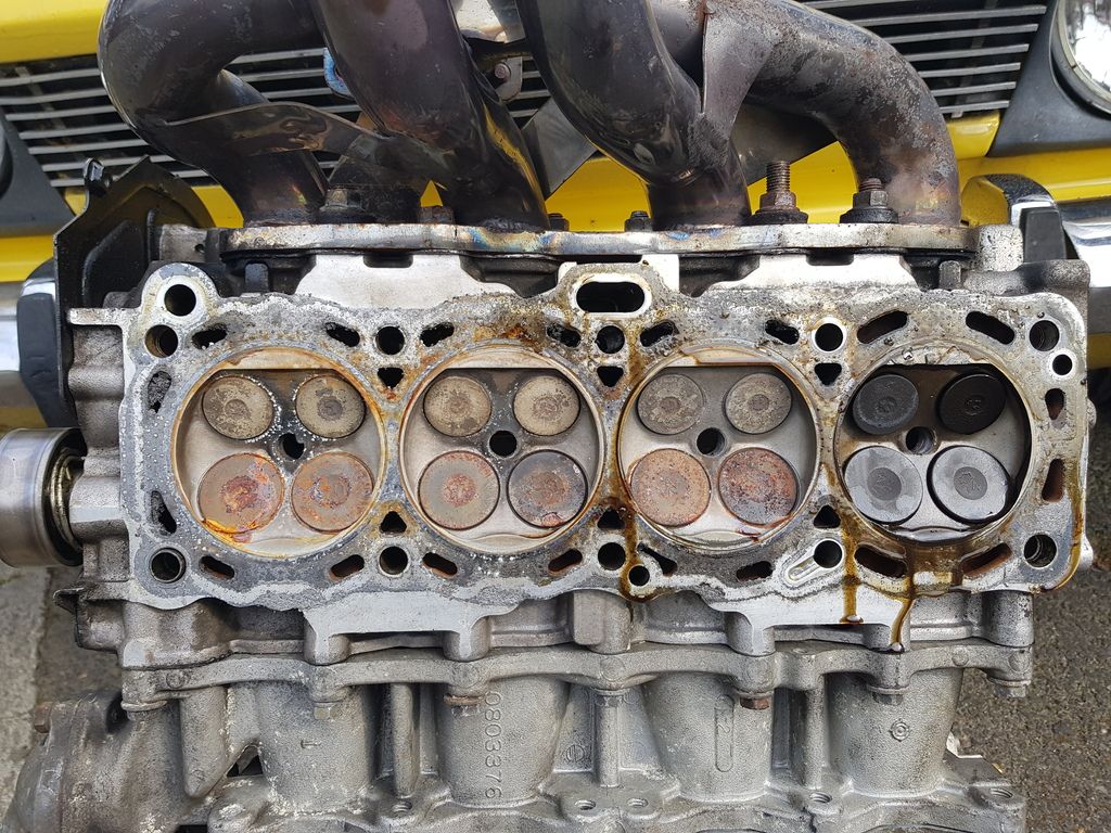

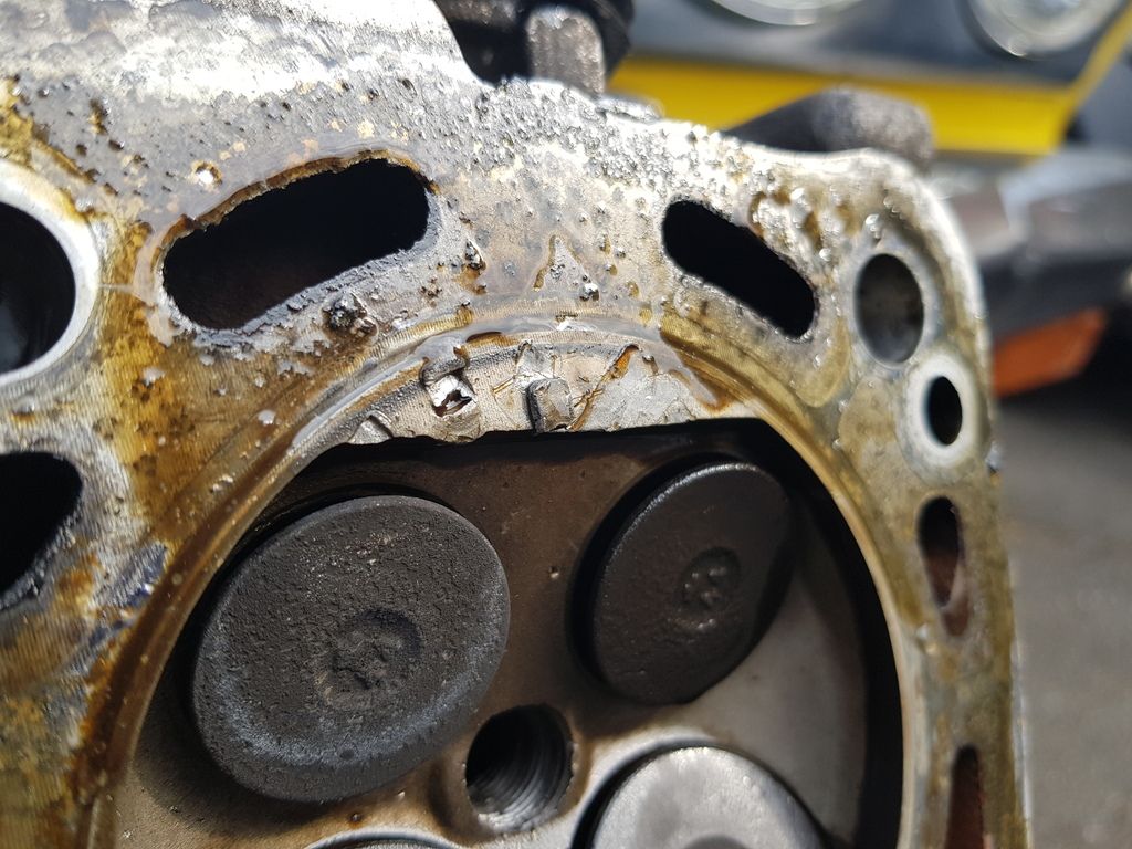

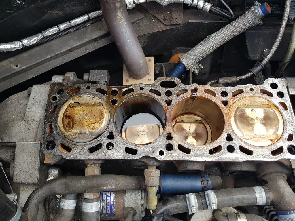

Right, following from the issues at Anglesey, the head has been taken off. No prizes for guessing which cylinder was loosing compression

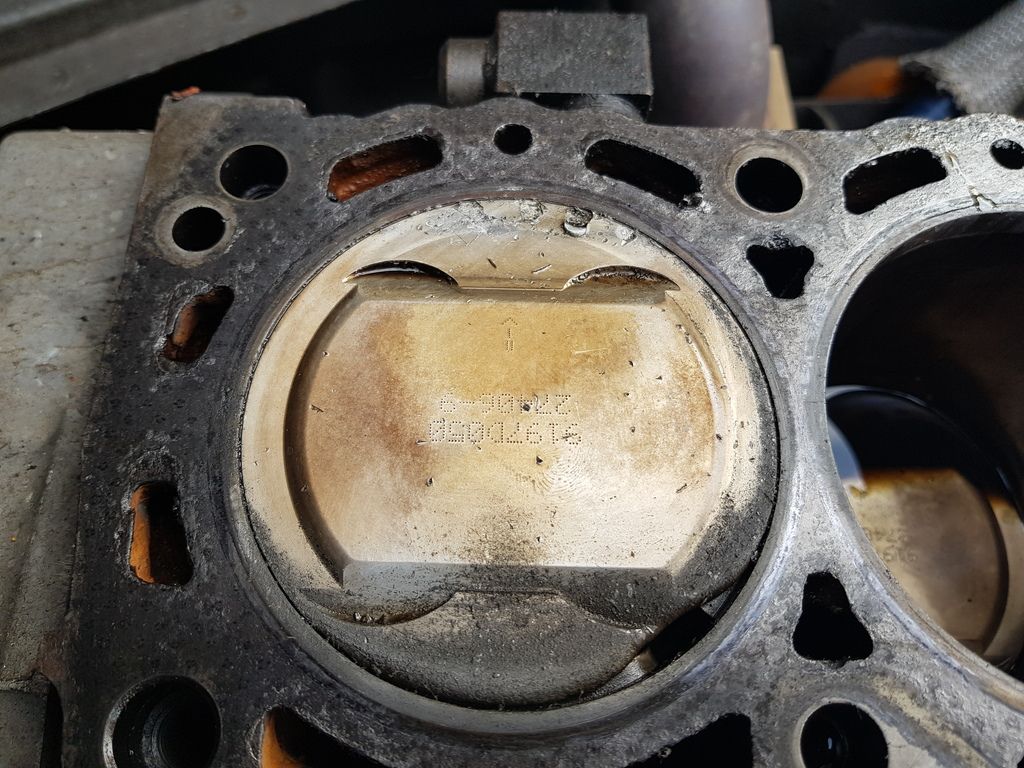

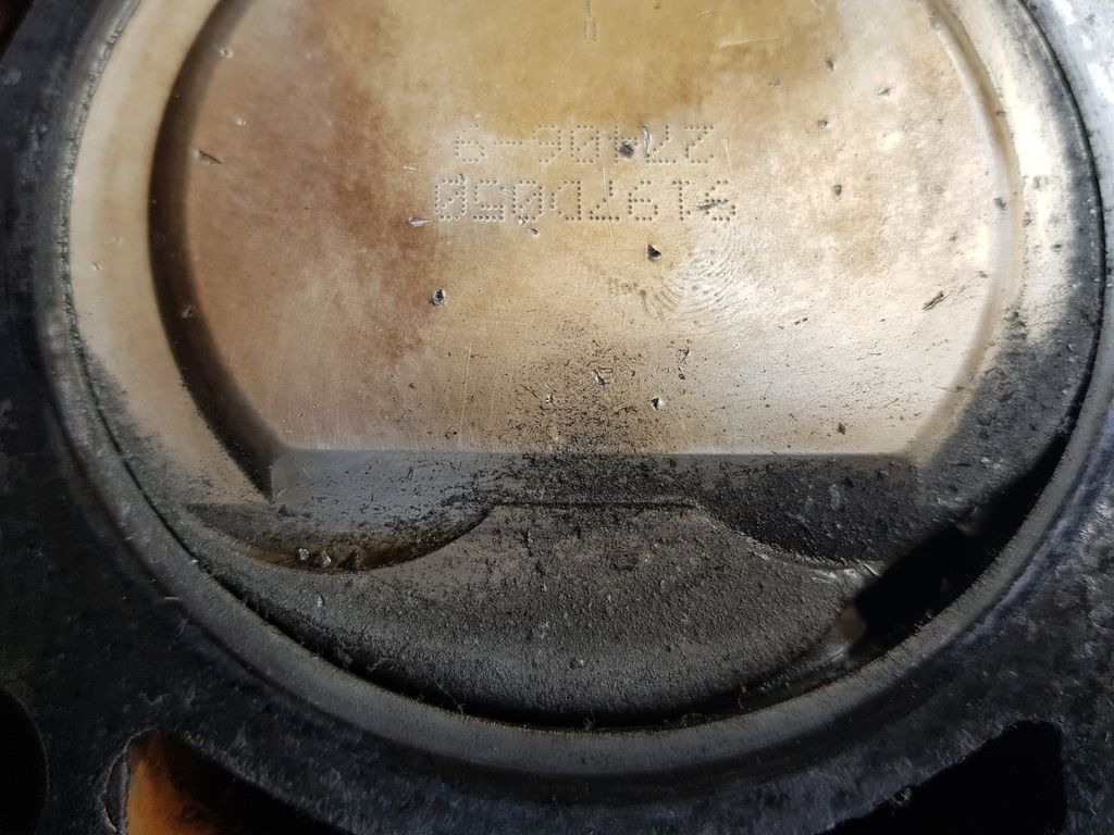

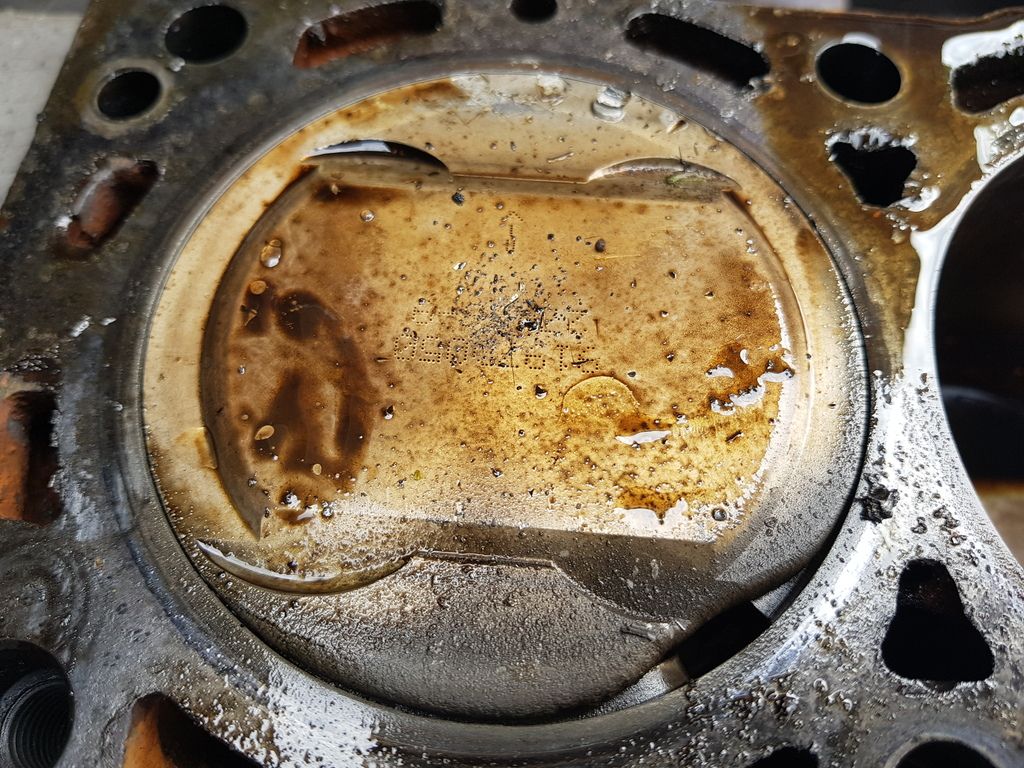

After a bit of cleaning, here's cylinder 3

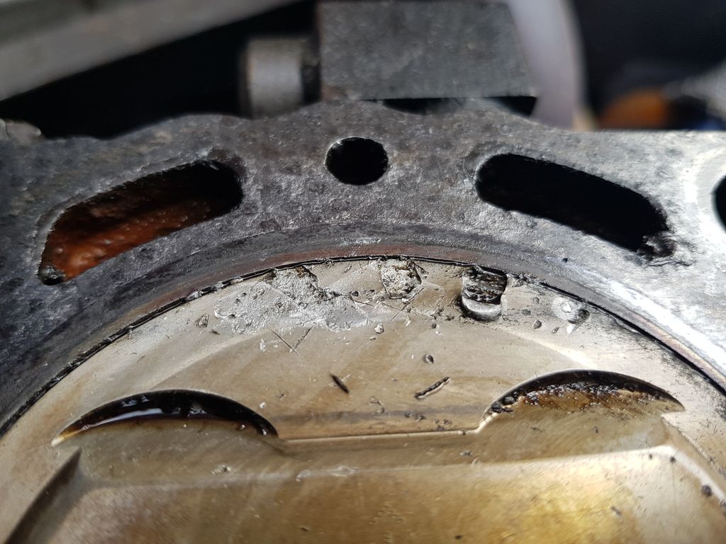

And now 4

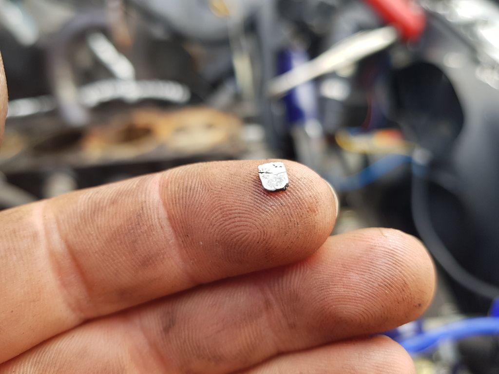

This little chap was wedged in the head but by the shape of it, I'm not really sure where it's originally come from

Ow! It's not the slightly squashed remains of a spark plug electrode is it?
- RSSOC Member
- Posts: 1030
- Joined: Fri Apr 24, 2009 10:11 am
- Location: Steeton, Yorkshire Dales
- Has thanked: 7 times
- Been thanked: 49 times
Re: Swoakes SS1 DET Sprint car oil filter
Broken ring, melted piston, bottom right of the second to last picture

Likely culprit is the spark plug or a valve seat if fitted

Ooh - hadn't noticed that chunk of missing piston

It's not plug electrode or valve seat. It does look like ring probably.
Yeah, it's a fair gap

That's knackered!!

edit:- should've gone to spec savers.
That doesn't look good
