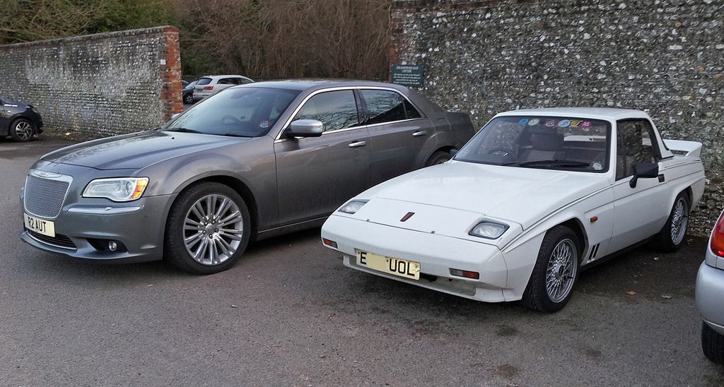

I don't share the problem of speedo visibility, but then I'm a compact (but beautifully-formed! :lol: ) 5' 8".
Compared with moderns the SS1 always looks tiny - at the last Goodwood noggin I parked next to a Chrysler C300, and the difference was amazing:
