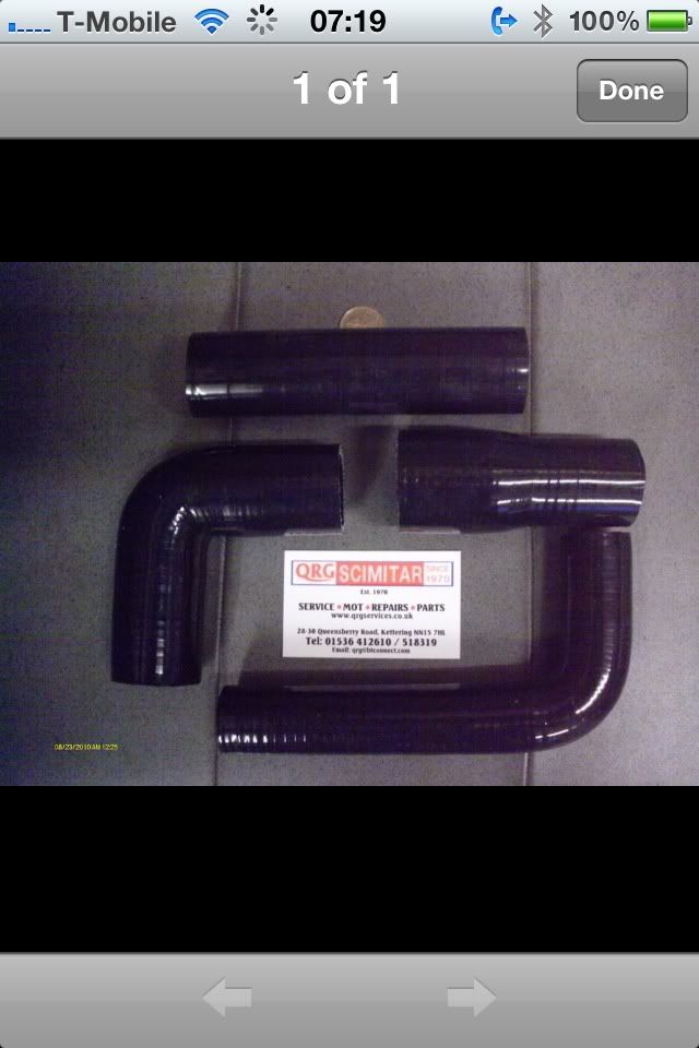

The other thread doesn't answer my question. I'm looking for the sizes for this set of hoses.
1969 SE 5 Manual O/D Rat Rod
hylton1806
Posts: 203
Joined: Fri Nov 20, 2009 6:32 pm
Location: NEWCASTLE
Re: SE 5 hose sizes
Post by hylton1806 » Tue Jun 05, 2012 10:46 am
Ref above.
Top 35id-45od 160 lg
Left 35id-45od 77mm x77mm internal
Right 40id-50od 35id-45od x110 lg
Bottom 25id-35od 185mm x 80 internal
Just bought a set and intend to fit them today. Have been told that the large one from the back of the water pump is going to be about 8 wks.I am just going to buy straight lengths off ebay for the rest. Any comments?
