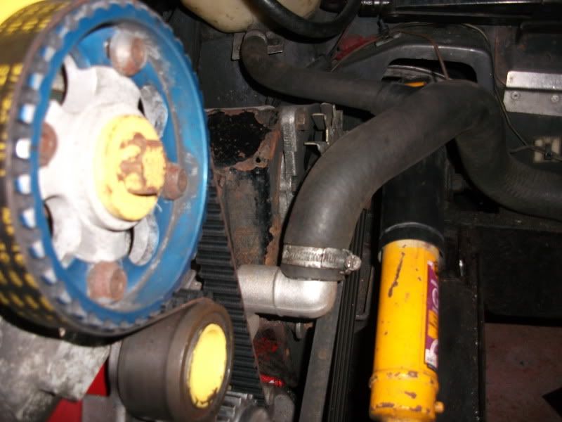

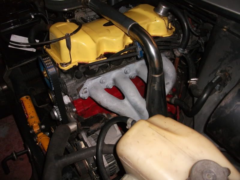

Post by Roger Pennington » Mon Jan 31, 2011 7:56 pm
Right, here we are, some photos of the relevant pipes. First of all here's the view of the main front pipe:
As you can see, the water pump has a single straight outlet, which goes into the first rubber elbow (under the alternator bracket) leading to the metal pipe with multiple stub offshoots (stainless in my case). This pipe then leads into a second large rubber pipe which joins up with the small metal pipe in lower left leading to the radiator. After this metal pipe things are I think the same as the earlier cars. As far as the small stub pipes are concerned, the lower one (in the photo) goes to the expansion bottle, the middle one goes to the heater, and then to the thermostat housing, as in my second photo :
And finally the stub nearest the water pump runs across the front of the engine to the water-powered autochoke as in my third picture:
The other pipe from the autochoke going to the inlet manifold.
Hope that clarifies things. As Phil says the majority of SS1s have the earlier arrangement so would be covered by that, but it's probably useful to know that there are other types about, so a standard set won't quite fit *all*.
