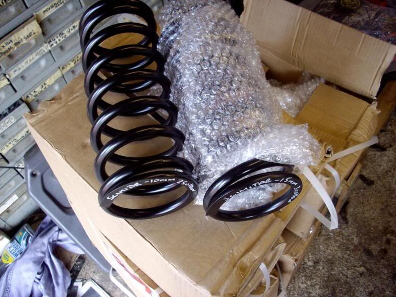

Spring ends have been ground. Could get away with it at one end, but not both :(

SS1 springs should be formed with CLOSED and UNGROUND ends, this leaves them with a "step" which when fitted, locates the spring in the lower wishbone seat and prevents it rotating. the spring to chassis location is isolated by a rubber doughnut, which is stepped to mirror the spring end profile.
The above springs have been formed with closed and ground ends, leaving them with a flat seat. This could have been overcome at one end by removing the rubber isolator. But it is not possible to seat ground springs in the lower wishbone, well, I considered the use of the upper rubber isolator, turned upside down, but whilst it would work, it's not advisable.

Post by reliant-reviver » Wed Oct 13, 2010 11:08 am
Right,
the springs have arrived and are all correct this time around!
I'll offer them up here first, and the remainder will be up for grab via buy it now on Ebay (at a slightly higher price due to the fees!)
"Road" spec: Sold out
250lbs/in rating
* -10mm at resting ride height.
"Fast Road" spec: Sold out
300lbs/in rating
* -15mm at resting ride height
Colletion in person or delivery via the Scimaritans is always welcome. Postage otherwise is £5.95 via courier.
To purchase a set of springs please email me via philipjandrew@hotmail.com to arrange payment via Paypal, bank transfer or cheque.
Cheers, Phil
