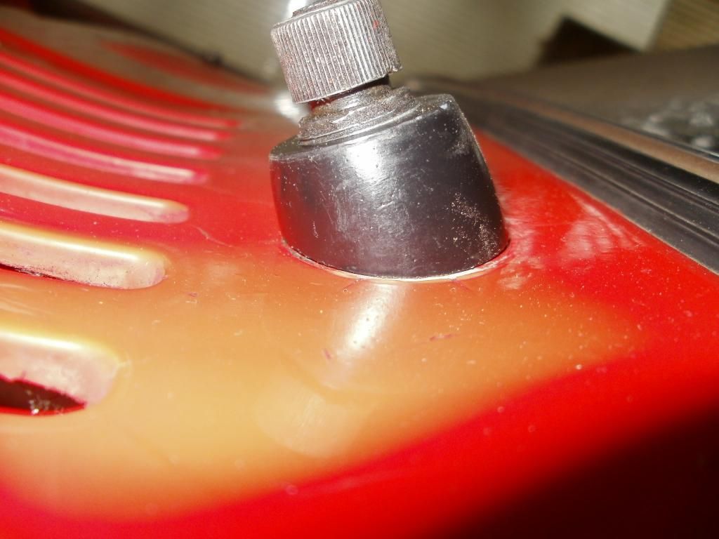

Post by windy » Thu Oct 03, 2013 4:22 pm
Shaved a bit of plastic off the lower sides with a Stanley knife & it sits pretty flush now, apart from the very bottom (hard to tell though in this pic) so will have to fettle a bit more. I'll need to take a bit off the top too, probably best done with the belt sander, so the nut will have some threads to screw onto

If the surround is as hard as seems it might be a good idea to trim a bit more off and also fit a thin rubber seal between it and the body, give it something to compress and ensure a decent watertight seal

I've been thinking along the same lines & going to look at self adhesive puncture repair patches next time I'm near a bike shop. I could stick them on the base of the bezel & then trim the excess off with a scalpel :) On my car I ended up trimming about 1.5mm off the bezels bottom on the windscreen side tapering to zero on the bonnet side to get it to sit parallel to the shaft

Yes, the new ones are a lot harder compound Phil, more like plastic than rubber. I wrapped some masking tape around the bezel & marked where I needed to remove material as its easy to take too much off with the belt sander

Steve, windy's post has an as fitted picture, think you'll need to dress to suit and put a flexible layer below to seal them eg rubber
