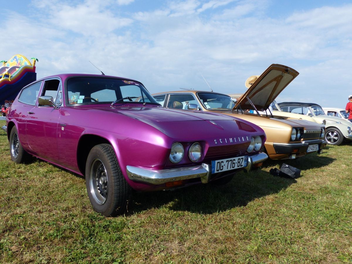

Beside maintenance, Purple had been busy during the summertime, attending a couple of events:
Showing at the Aeromobil airshow in Pouilly en Auxois at the end of August, together with Ian's Candy:
viewtopic.php?f=104&t=33666

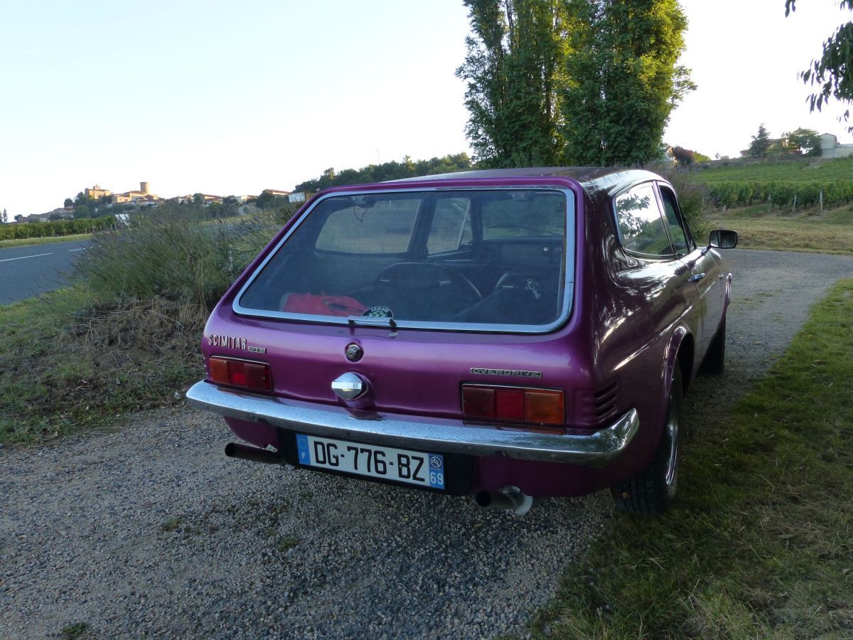

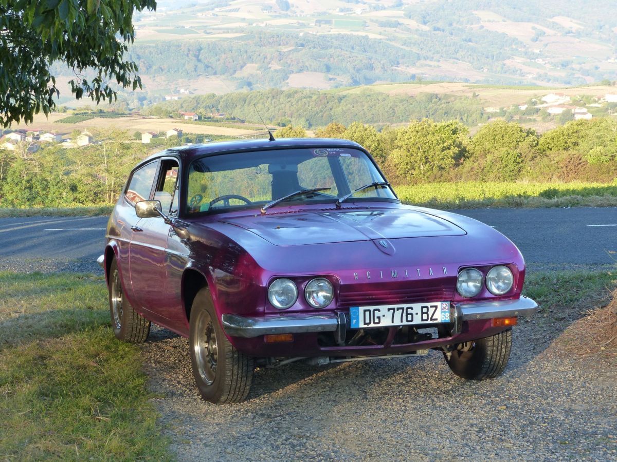

Taking part in the Sortie South-o-France 2016 in Lyon at the end of September:
viewtopic.php?f=104&t=31133

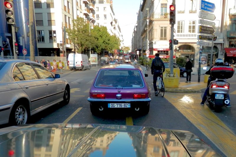

Next photo courtesy of Chris (DARK STAR) ... boy, Scimitars do look small by nowadays' standard :shock:
