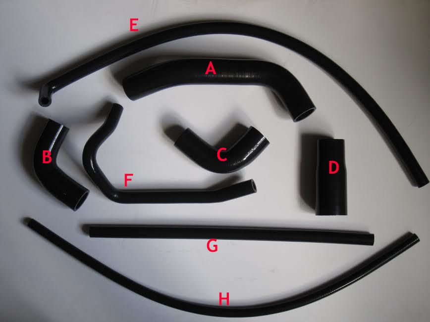

I have been on the phone to Mary at "Classic Silicon Hoses Ltd" who have a set called "Reliant Scimitar 3.0l V6 GTE 3". She is not sure which model this set will fit as someone recently reported a problem with the shape of the hoses - this might have been for a Coupe or a SE6 or SE6a model, she really cannot remember. Before I order a set at huge expense, has anyone else fitted this set to a SE6a with totally standard cooling setup please?
To add to the confusion this picture is Shown on their website as Reliant Scimitar 3.0l V6 GTE:
And she emailed this different picture to me, called "Reliant Scimitar 6a set".
Reliant-Scimtar SE6a.png (329.68 KiB) Viewed 1473 times
Many thanks, Adam

The second set in the picture looks more like I would expect (I think the first one is Se5a?)
*Assuming* that the sizes are right (difficult to tell from a photo, obviously) then I reckon that set breaks down as follows:
Where:
A = Water pump to bottom metal hose
B & C = Radiator hoses
D = Top Hose to thermostat housing
E = Heater to water pump
F = Thermostat housing to autochoke (this looks a bit more "bendy" than I remember, but may give more clearence to the dizzy)
G = Autochoke to heater
H = Thermostat housing to expansion bottle
Which should be what you need.

I'll follow this with interest, as I too need an SE6A set of hoses and was looking in the same place. I can't see anything in the photo that looks like it connects the output of the radiator to the thermostat housing though (unless D has been shot from a funny angle).
Please let me know how you get on as new hoses is one of many things that need doing!
Tom

Stat housing is connected to a steel pipe by D. Other end of steel pipe is connected to rad by B or C (can't remember sizes offhand but I did take some pics when I fitted a set)
Edit - here
38mm 90 degree reducer to 35mm. Just had to cut mine off to get my rad out so I could remove the steering rack to send up to Mark for rebuild. Sent for a replacement pipe from here http://www.ebay.co.uk/itm/221476401897? ... EBIDX%3AIT as I've bought from them before.
